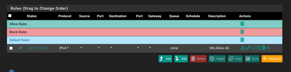

We have a wireguard tunnel set up and we are having no issues accessing any of the devices on the default network. However, we cannot access any of the on the vlan interface subnets. There are no firewall rules on the subnet interfaces preventing traffic from reaching the Wireguard networks. The only rule on the Wireguard interface is the default allow all rule. And the client peers have the corresponding networks added in the AllowedIPs section. We have tried everything we can think of and have not been successful. Can anyone provide some possible solutions?

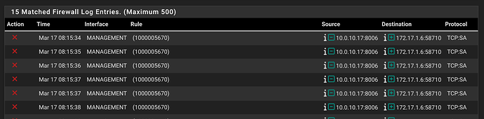

I reviewed the system logs for the wirewall and searched for a IP we were tying to reach through the test and we see the below:
It would seem some rule is causing this? How can we determine what firewall rule “1000005670” is to determine what is causing this?

In ran the following command:
pfctl -vvsr | grep 1000005670
The results:
@83 block drop in log on ! ix0.10 inet from 10.0.10.0/24 to any ridentifier 1000005670
@84 block drop in log inet from 10.0.10.1 to any ridentifier 1000005670
@85 block drop in log on ix0.10 inet6 from fe80::225:90ff:fee0:802a to any ridentifier 1000005670
I am not sure what rule this is referring to.

Since it is coming from your Manangement interface check the firewall rules there. Hover over the States fields and you will see tracking id which should be the ridentifier. This way you can see what rule to correct.
