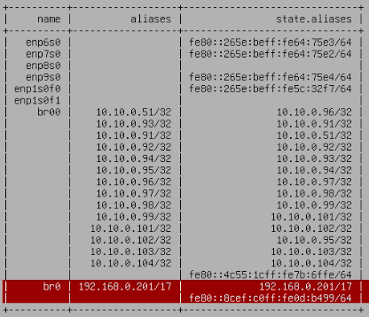

A while back I created a 192.168.0.1/16 bridge interface on TN to match my pfsense LAN1 192.168.0.1/16 address space. The /16 was just part of fiddling around with stuff. Now I want to do things properly with VLANs and whatnot.
I cannot delete the TN 192.1680.200/16 bridge interface br0. I can shrink it to a /17 and change the IP address (say from 192.1680.200 to 192.1680.201) but when I delete br0 and test the changes, lose access to the TN UI until the test period of 60 seconds is over.
On TN I have VMs and Docker containers (both through its own catalog and through Docker Compose).
On pfsense I set up LAN2 as a 10.10.0.1/24 network on a different switch. I moved everything on TN to LAN2 (firewall rules enable all traffic everywhere for now). The TN UI is on 10.10.0.51.
I downloaded the TN config database and searched through all tables using a SQL tool and the only reference to br0 or 192.168.0.200/17 is the bridge interface definition itself. Nowhere else.
As a test I tried moved br0 from enp6s0 to enp7s0 and that worked. Although I cannot see anything using br0 in the TN config DB, when I unplug enp7s0 from the switch, I lose access to the UI.
Also, if this is relevant, the TN UI loses its connection to the TN server very frequently now, where as it did not before I shifted everything over from the 192.168.0.1/16 network to 10.10.0.1/24.
Something odd is going on and I have exhausted my limited network knowledge and this issue is driving me MAD. Please help!

Hello Tom. Yes, I did through the console and with the same result: after applying the change, access to to the UI is lost and the change rolls back after 60 seconds and UI access is restored.
I can’t even find any logs with any information at all relating to this attempted network change. The console shows nothing and I have looked in /var/log but I cannot find anything relevant.

I did attempt to remove br0 through the console and with the same result: after applying the change, access to to the UI is lost and the change rolls back after 60 seconds and then UI access is restored.
I did not try to remove any of the other interfaces or bridges.
I managed to remove br0, but only by the high-risk thermonuclear option.
I downloaded the TN config DB and manually edited that to remove br0 and its references but the upload failed due an authentication token error - usual useless TN error message.
So then I uploaded the modified freenas-v1.db file to /data/ as freenas-v1.db.nobr0 and backed-up the original DB file. Then I swapped the DB files over. Live. And then rebooted the system.
After reboot, the UI was not accessible but in the console I reconfigured one of the interfaces for DHCP and rebooted again and then the system was available again through the UI.
There were quite a few network config things to tidy up, especially with Docker containers but everything’s now working fine. I suspect that it was the Docker subsystem that had a hook into br0 but I saw no way in the UI to change that and by this point TN had got its knickers in such a twist that non-anesthetised surgery was the only option.
If this live DB change had not worked then providing the system booted up, I could have swapped the DB files back again. If the system had not booted then I would have had to figure out a solution for that.
I would not recommend this option to anyone, but I am confident that after having tried everything else for weeks, there was no other choice than this last resort.
