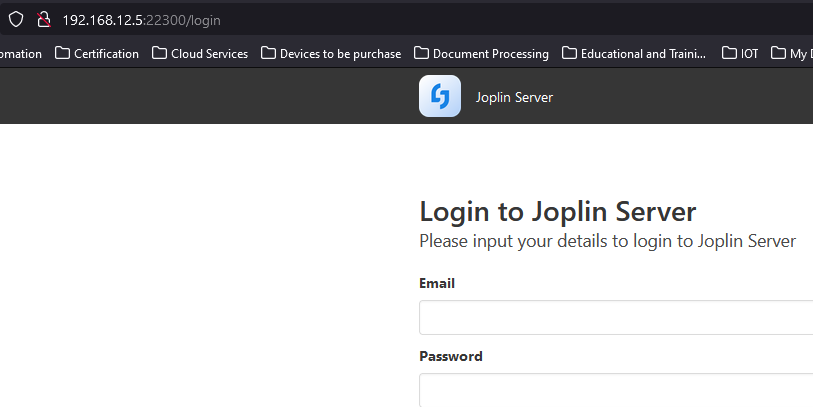

I have a problem where a server hosted in a docker cannot be accessed when behind pfsense haproxy. Please help me identify what configuration mistake I have done or a setting that I may have overlook.
I have setup a docker server and setup portainer, freshrss and joplin in it. All of those will only be accessed internally via haproxy. If I access them directly they are working fine:

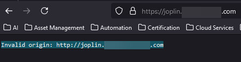

Once I have place them behind the haproxy and access them by name it failed:

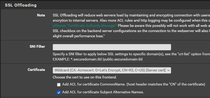

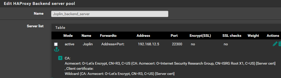

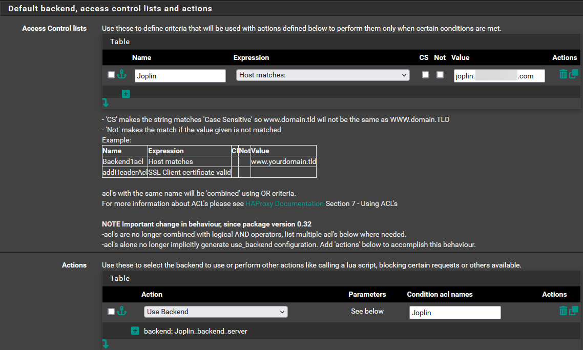

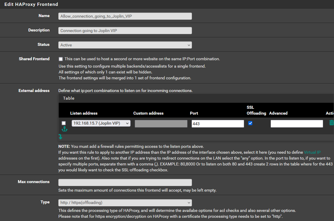

Below are my haproxy settings:
  1. Virtual IP
  2. Backend
  3. Frontend

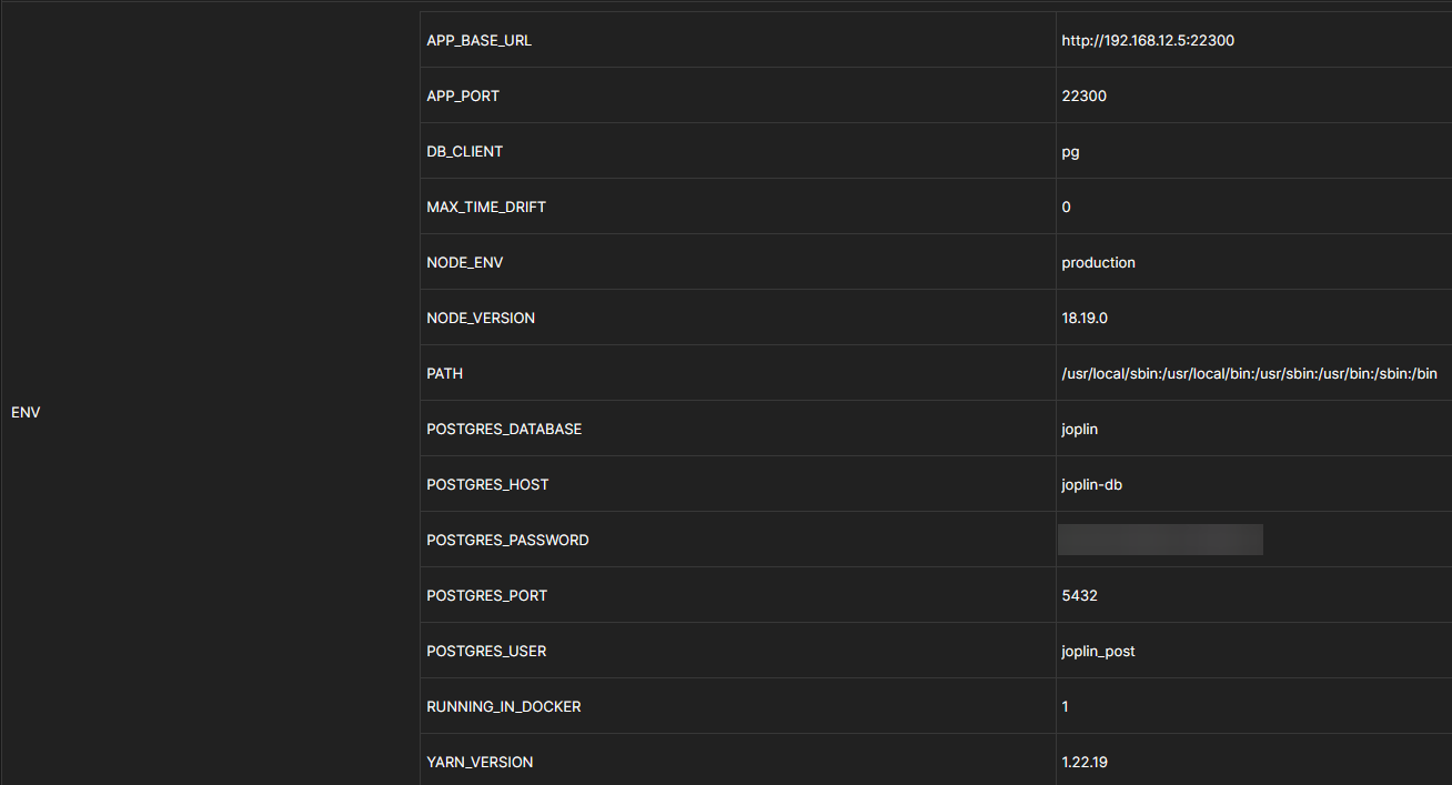

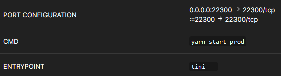

  1. Joplin settings:
Joplin has a GitHub issue for reverse proxies. I don’t know it right off the top of my head but I ran into this when I was setting up a Joplin server in docker.
EDIT:
The issue is closed but you will need to find a way to add what people are suggesting in the comments.
