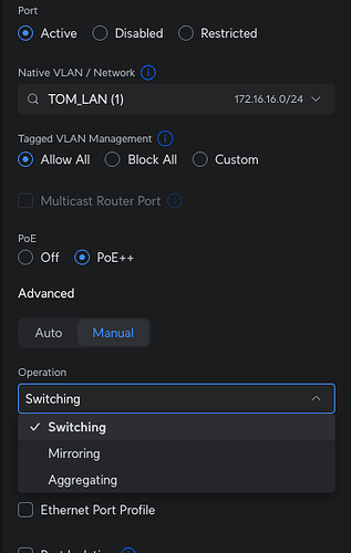

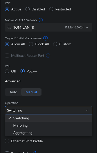

Yes, should be supported on all switch models other than “Flex” units. It’s called Port Mirroring.
I do see the port mirror option, but this is only for one port. I need a SPAN port that will mirror multiple ports for use with a SIEM. I see some workaround that doesnt survive a reboot, so maybe I wont be able to run a UI switch in this case..

no SPAN port on Unifi switches. Maybe with the Enterprise line, dunno bout that. a SPAN is really not useful if the ports are quite busy, though. I solved this by mirroring the trunk port connected to the router. That is a “router on a stick”, so might not apply to your situation.
UniFI calls the Port Mirror and I think it’s supported on most all models (certainly more than just the pro and enterprise)
I see the port mirror option, but thats just for one port. I guess I misspoke - I am looking to feed SO as an IDS and not necessarily as a SIEM (i do have all of our devices and endpoints shipping logs to SO for its SIEM function)
