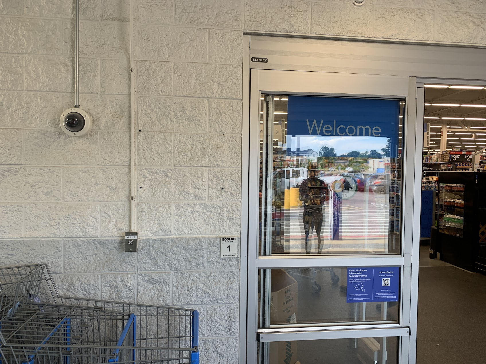

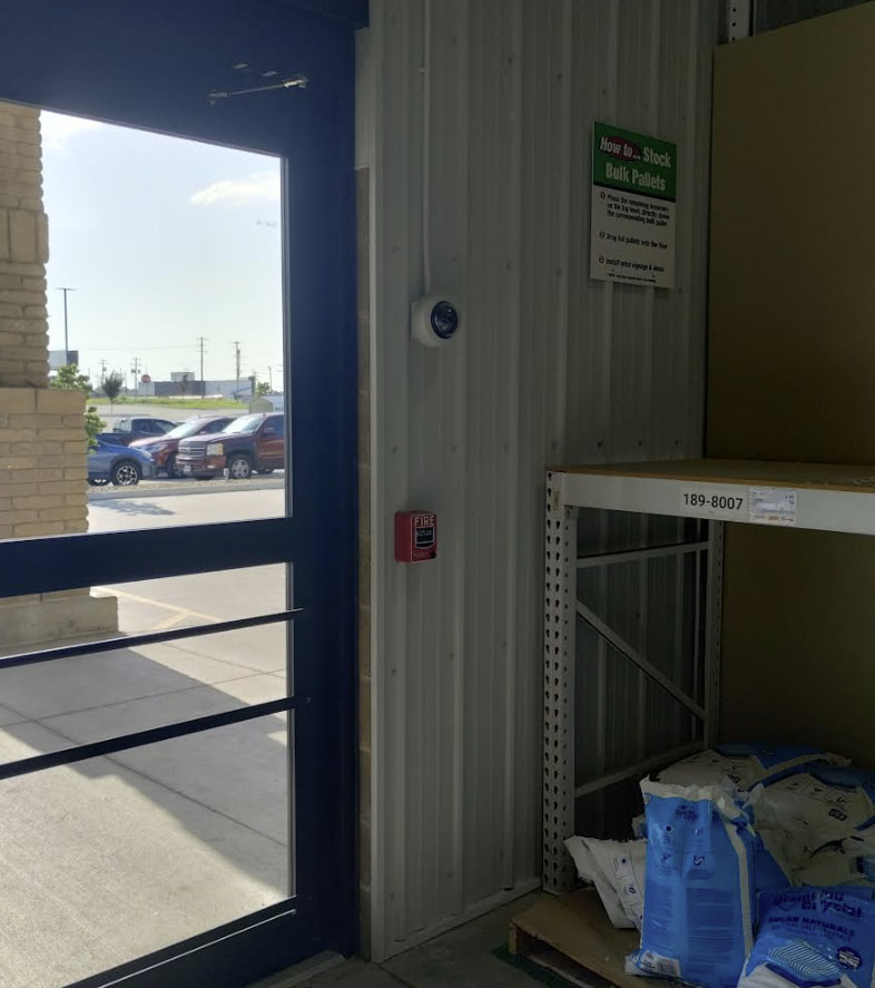

Also, if you want to see an example of cameras mounted roughly at face level look at the entrance/exit of your local Walmart and Menards.
Here is an example from Walmart.
Example from Menards
