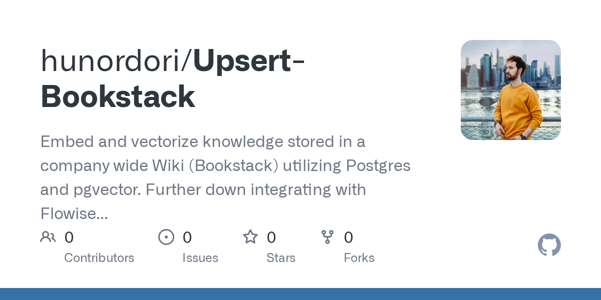

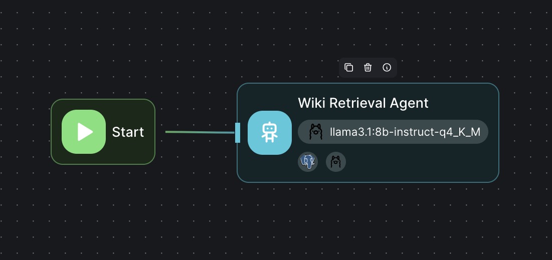

I created this Python script* that embeds a Bookstack instance’s content to a Postgres DB. My main goal is to use Flowise AI, create a chatbot that answers user questions.

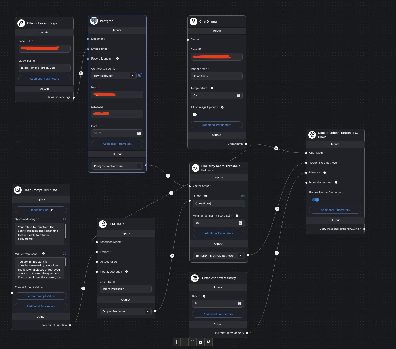

  • Our organization method (Shelves = departments, Books = bigger topics, etc) does not translate well with similarity search. Humans narrow down the topics, but AI just searches for similarities
  • . Somehow cosine distance strategy doesn’t provide good results, but Euclidean and inner_product do
  • The content and the formatting really matter and influence the retrieval
  • using a lower temperature (0.3-0.4) is recommended, which yields better results
  • it is really important to use Ollama and local models (sensitive information)

  • integrating it with Flowise
