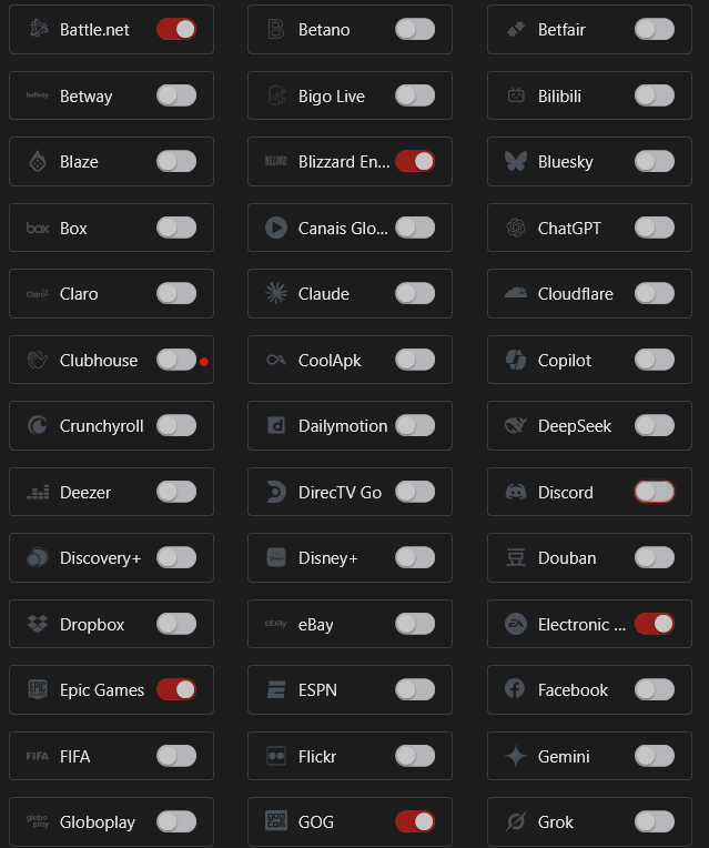

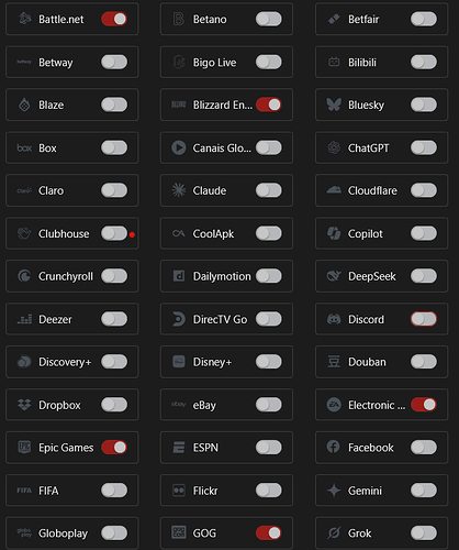

With AdGuard Home, you can block services on a schedule. Most games/game services are available in the interface to be blocked (Battle.net, EA, Epic Games [Fortnite], Minecraft, Riot Games, Valorant, Roblox, etc.). You can also override DNS TTL’s.
So if I block Epic Games and set up a schedule, and override the TTL, will Fortnite stop playing immediately when the schedule ends?
I wouldn’t override the TTL to zero. That could cause other issues. But you can set it pretty low, like 10-30 seconds even. Note that the client will also likely cache the DNS record with the same TTL, so 30+30 would be 60 seconds from the last time the record was queried. Add that to the schedule time.
Hard to say if Fortnite would stop immediately. My guess is it would hang shortly after before giving a lost connection error/warning. It really depends on how frequently the client needs to query the Fortnite service.
Best way to know would be to test. I don’t play Fortnite, so I can’t help you there.
