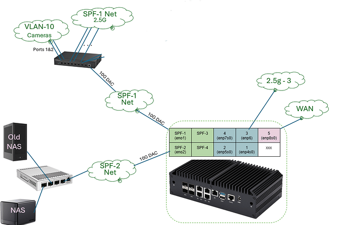

The problem is that my Chino-Special router has four SFP+ network ports, four 2.5g ports and an admin LAN. When I tried to move my OpnSense VM from one machine to the other, the network interface mappings didn’t work. I am pretty confident I set up each machine in the exact same way taking care to name all the interfaces the same and do them all in the same order. Alas, it failed.
Anyone have similar challenges?
My network initial design. The Qotom on the lower-right is what I actually have two of. Trying to figure out how to easily keep both up to date and be able to swap them if needed.
