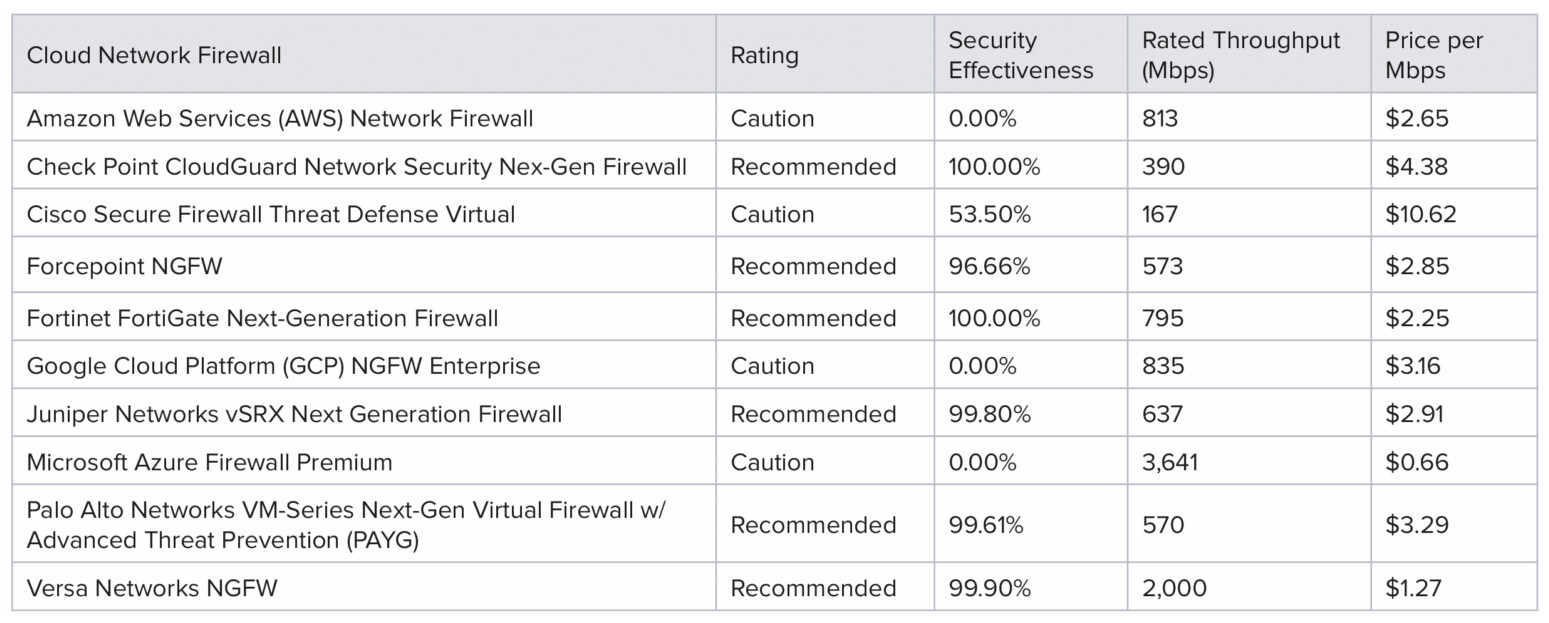

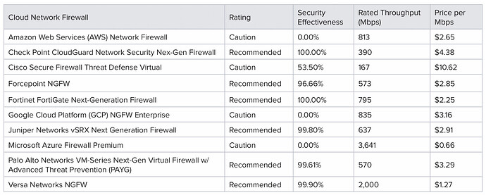

I use Palos and they are one of the best on the market IMO. You can check Gartner or Cyberratings.org. I can appreciate that Fortinet wouldn’t be a popular choice, but I would check the CVE to see if it affects a feature you would be using.
Either way, here is a nice chart to get you started. CyberRatings.org Publishes Test Results on Cloud Network Firewalls - CyberRatings
