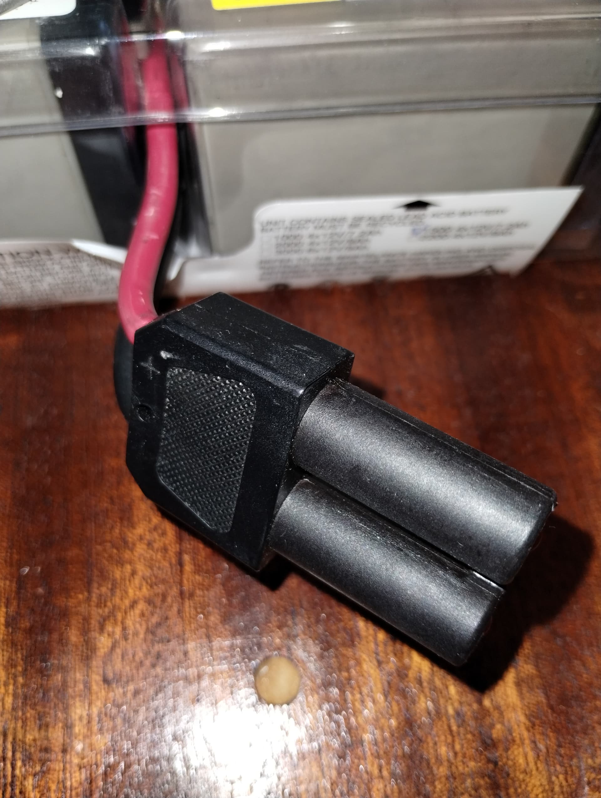

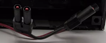

Looks like an Eaton/Lenovo battery connector. I think they are EC type. Maybe this site will help you: Exploring LiPo Battery Connector Types | Grepow. Here is a picture of one from my backup Lenovo battery pack.

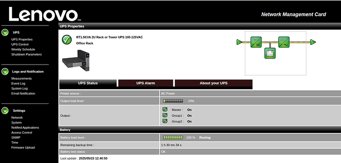

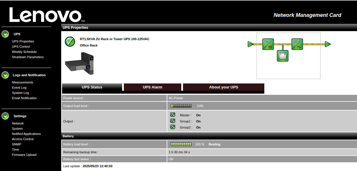

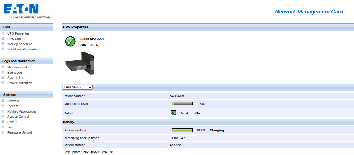

For “enterprise” models, I suggest that this is the case. I have two UPSes, one a Lenovo Lenovo RT1.5KVA and the other an Eaton 5PX. They both use similar batteries (and connectors) and network monitoring cards are both Eaton but the Lenovo uses firmware branded “Lenovo”.
