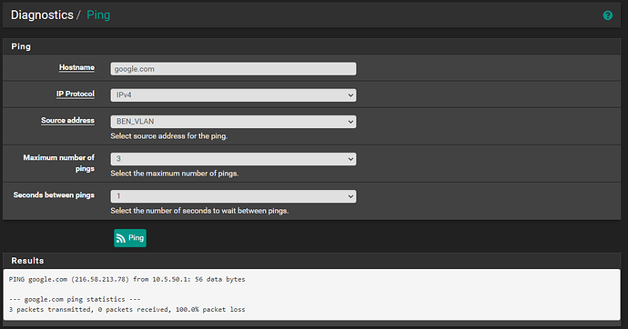

On pfSense, Is it normal that I can ping 8.8.8.8 but not google.com?
I come home 2 days ago to discover that all my vlan are no longer able to connect to the internet. They all can ping 8.8.8.8 but not google.com

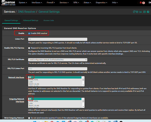

This is a DNS issue. Make sure the DNS service is up and your upstream DNS servers are accepting requests in System → General settings on pfsense.
The DNS is enabled for all interfaces

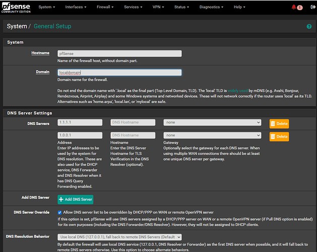

In System → General settings I have the following:
I would untick ‘DNS Server Override’ then pfsense will use the dns servers you specified.

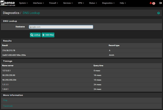

What happens if you do an dns lookup under diagnostics
Are you blocking dns queries to the internet ?
All seem ok. I am not blocking DNS queries no.
I also untick ‘DNS Server Override’ but nothing changed

why do you have 90.255.255.90 as a DNS? this is Vodafone service in the UK.

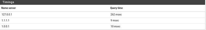

my table:
