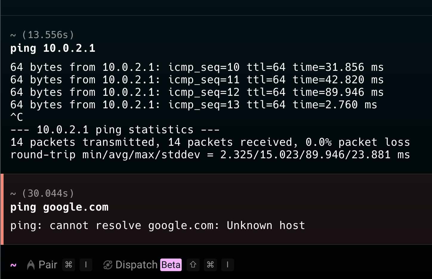

Since I couldn’t load any websites, I decided to open Terminal and ping google.com
The following message appears : ping: cannot resolve google.com: Unknown host

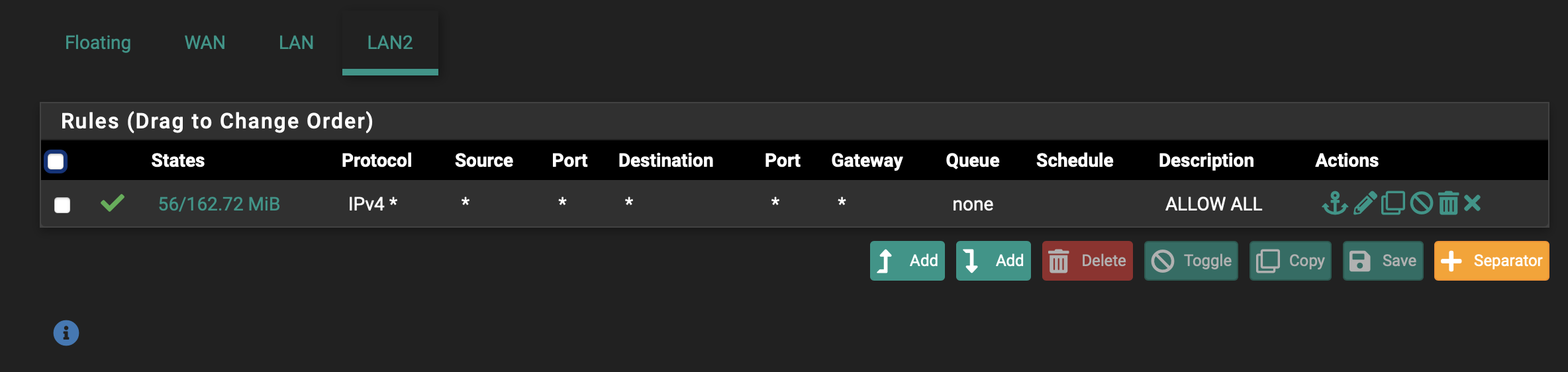

  • Here’s a screen shot of what the rules list currently looks like :

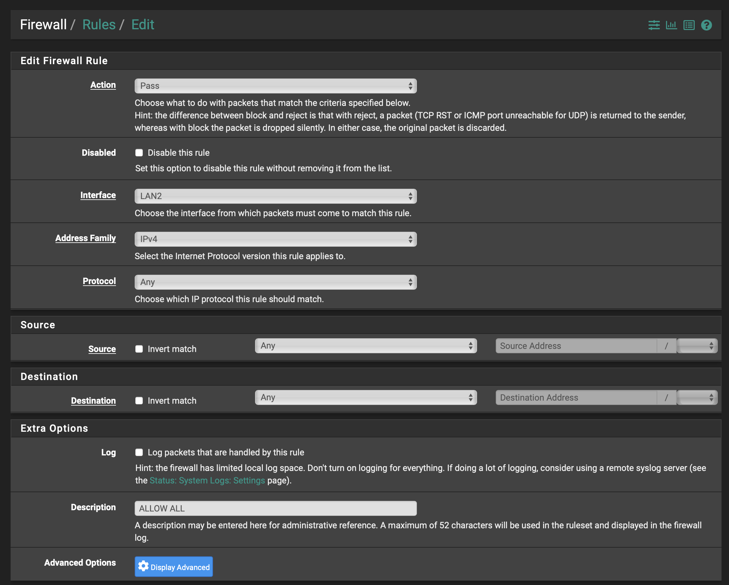

  • And here is the configuration of the rule :
That is indeed an allow all rule so you can rule that out as the cause. Check to see if you can ping the pfsense itself to see if the physical layer is working.

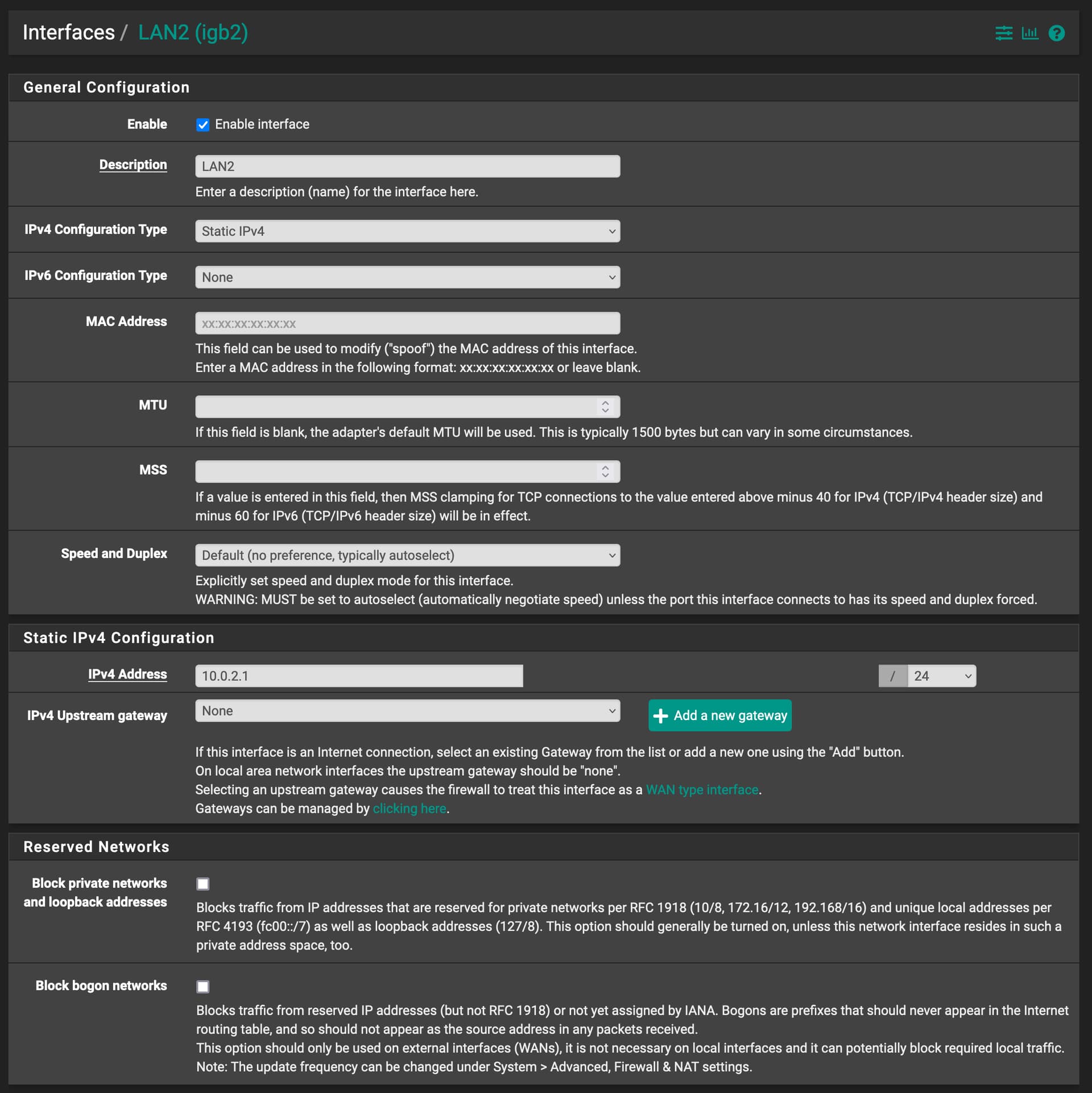

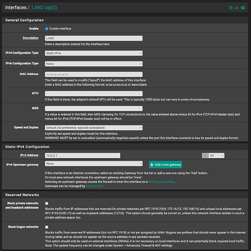

show the Interfaces > LAN2 screen.
@LTS_Tom yup, I set the LAN2 Static IPv4 Configuration to be 10.0.2.1 and this is what I get :
@pavlos here’s the Interface configuration :

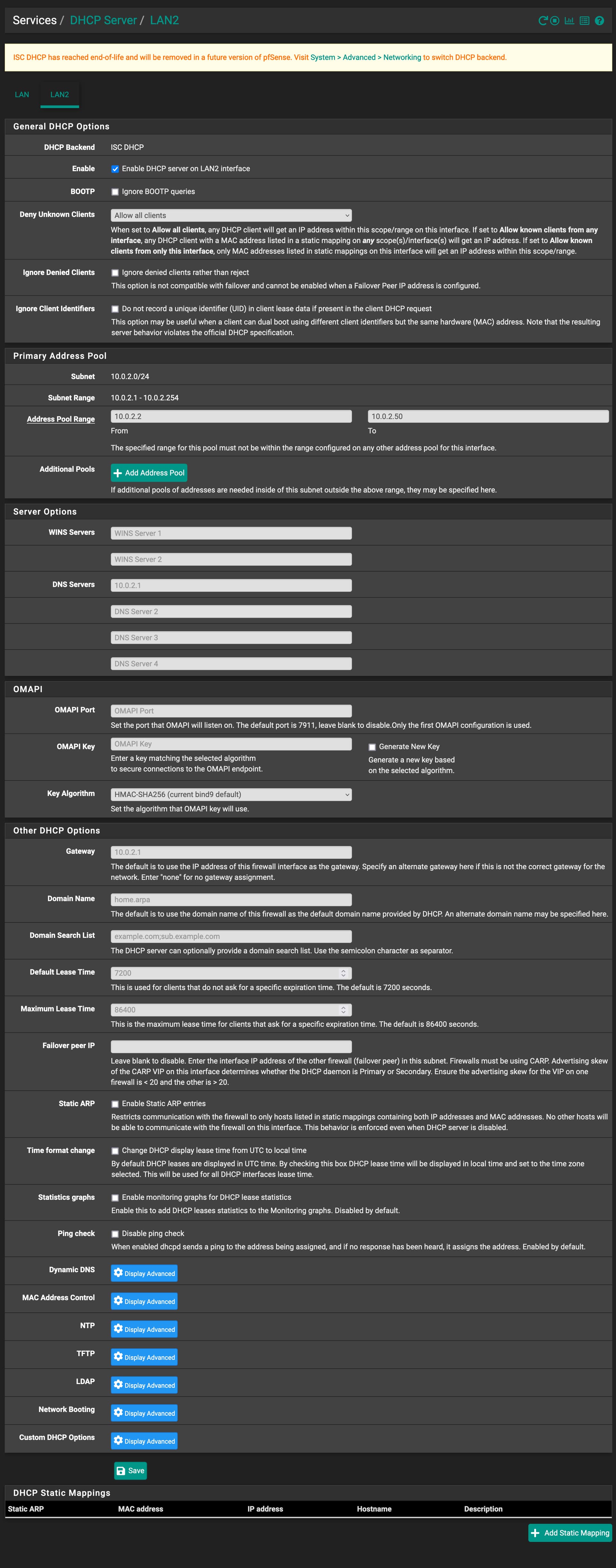

did you configure a DHCP server for LAN2 ?
Yup, and I made sure not to have a space at the beginning like how Tom accidentally copied and pasted it when defining the IP range :grin:
what DNS do you use in the DHCP Server for LAN2 ?
It makes it easier if you post screens …
I left it at default.
I assume your LAN is 10.0.0.0/24 and its DNS is 10.0.0.1
Then, update your DHCP for LAN2 to use that DNS, 10.0.0.1
