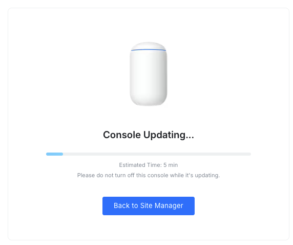

I manage four sites, each with an original Unifi Dream Machine. They are all set to auto update every week. Unfortunately two of my four UDM got stuck in the update loop. The network and internet is still working fine, so no immediate action required. Still, at some point I need to get these UDM out of their loop. Any suggestions for best practices? Thanks!
If they are still routing but not bringing up the Network app a simple power cycle should fix them. If you have SSH access you could use that to log in and figure out why the app is not starting.
Update on this topic: with no SSH access, my only solution was to unplug the Dream Machine. Once I plugged it back in, it kept blinking white. So I had to do a full reset and restore from backup.
Update on the second Dream Machine. After unplugging it came up normally in the Unifi controller, however, still at UniFi OS 5.1.12.. Unfortunately, I forgot to enable SSH. Last night, it followed its update schedule to update to UniFi OS 5.1.19. Now it’s unavailable again in the controller while still routing. What a pain :frowning:
