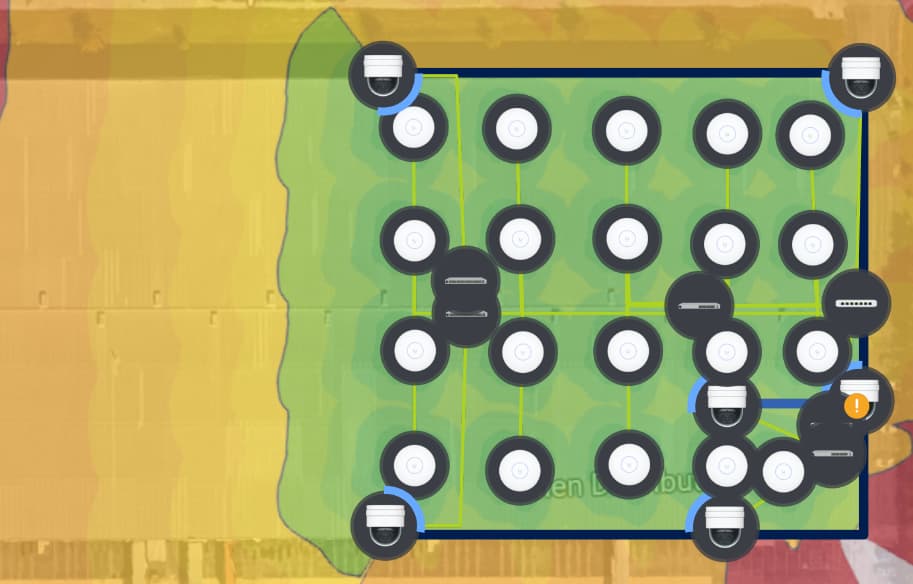

I am looking for recommendations for AP density for a 100,000 sq foot warehouse. I have a lot of experience with networking and APs, but we have not done any deployments in a warehouse.
The ceilings are about 35 feet tall, and the space is about 330X320 feet. there will be about 7 Aisles with about 20-30 feet of dead space between metal racks. I am leaning towards U6 enterprise APs I used the Unifi design tool, but I wanted to get some ideas from someone that has done a warehouse recently. They are looking to have about 250 devices connected to wifi.

I don’t believe the Unifi Design Tool has the appropriate wall/obstacle options to account for metal shelving. No predictive design is going to get it right, but others have more robust options. But that’s a factor of paid vs free.
We did a project very similar and using more WiFi to solve the problem of lots of metal racks was the solution we went with. This project is still going great from over 4 year ago.
