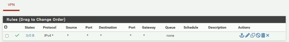

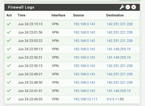

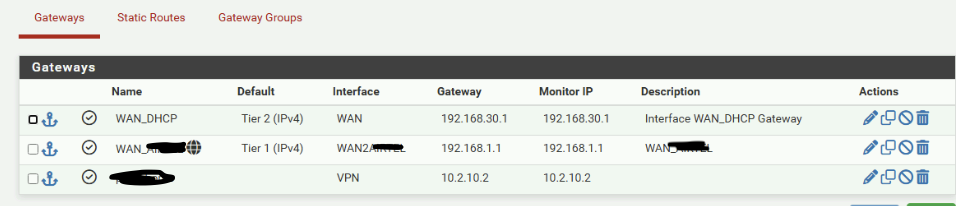

I have a WireGuard VPN configured in my pfSense, and I am trying to route some traffic through that gateway, but I’m unable to do so. Here’s what I want to achieve:
Traffic to google.com[142.251.221.238] (using it as an example) should be routed through the WireGuard VPN gateway to use a static IP of wire-guard VPN in my pfSense.
Can someone help? I’m not sure what I’m doing wrong. I tested the same WireGuard client from my laptop, and it routes to the IP fine.

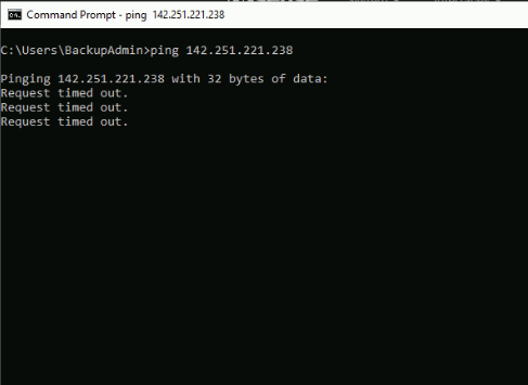

Ping from Pfsense Client :
Ping from my laptop that is not the client of Pfsense but it is connected to Same Wireguard VPN tunnel :

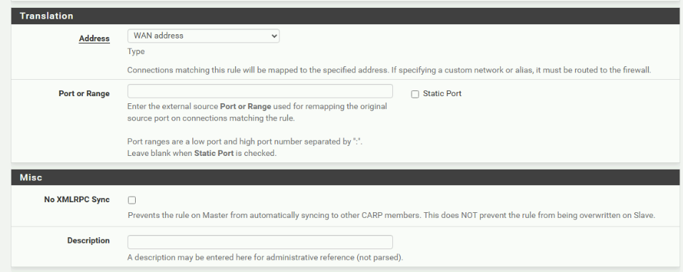

But I still have one more question since I have a dual WAN setup. What does this mean exactly?
Should I keep the default settings, or is there anything I need to change here?
We face a lot of issues with the internet going up and down, which is why I’m using dual WAN.
Please advise.
If you had to make a translation rule for one WAN you will probably need one for the other WAN as well.
