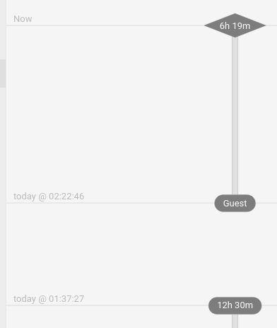

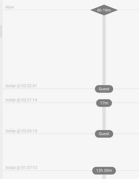

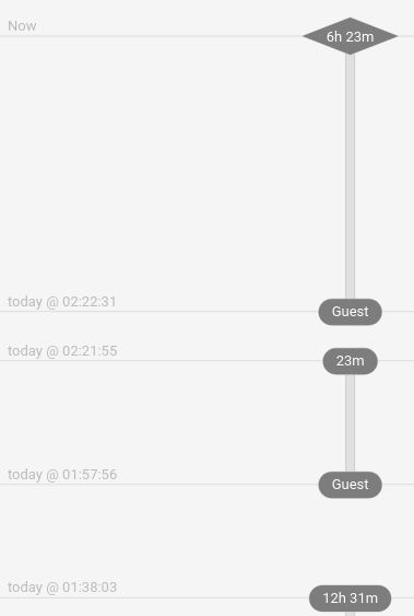

@Greg_E there have been minor glitches all the way through. Some clients dropping off for 30-120 seconds but alas, here are a few samples from last night.
It doesn’t matter, because it happened during the night but if the same happens during the day…there are going to be problems.
client1
