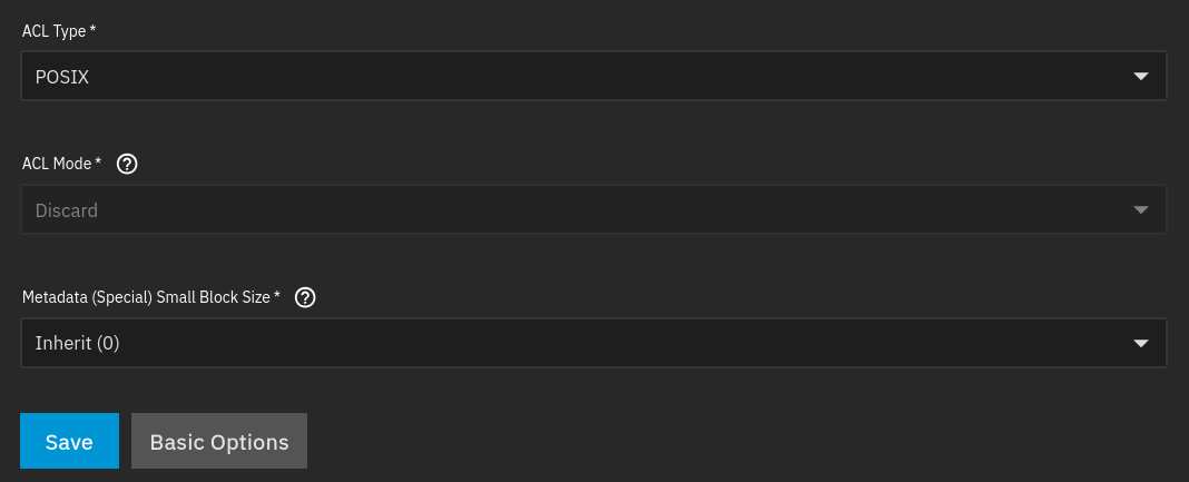

Hello,
I have had the same issue with that as well where I would just like to mount the nfs shares to the container. the way I got passed this issue is you must set the dataset ACL type to POSIX. (it will be under Advanced Options)
Then you will need to maproot user to root`, and the Maproot Group to wheel (it will be under Advanced Options in Edit NFS Share)
And then you can just mount it to the volume just like any other compose file.
volumes:
volumes:
  linuxisos-movies:
    driver: local
    driver_opts:
      type: nfs
      o: addr=10.30.30.101,rw,nfsvers=4
      device: ":/mnt/DataDumpster/Linux_Isos/movies"
hope this helps someone out.
