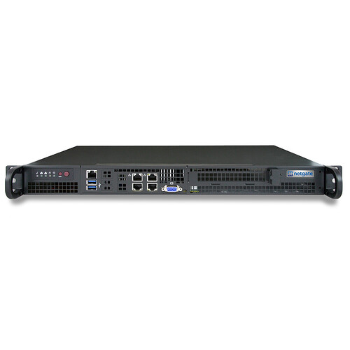

I’d say Netgate are the best people to give you a response. However, some of their higher spec’ed routers ought to do the job. There are some performance metrics if you search their site for the various routers.

They have specs for their systems on their site:
