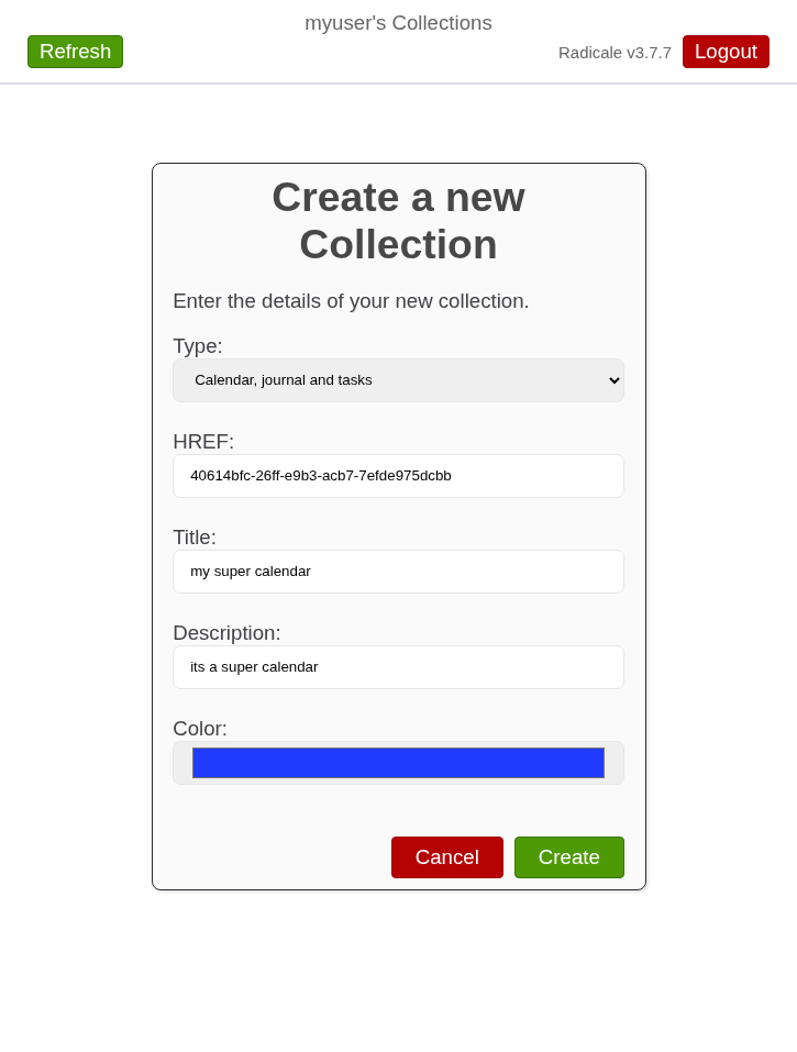

Open a web browser and navigate to the http:// then wherever your Radicale
container is running. You should arrive at a login screen. Go ahead and login to
the UI using the account we setup earlier, if you followed along precisely it
will be, myuser and somepassword. Once you’ve logged in you arrive at a
fairly blank page. Click the plus down on the bottom.
You will end up at this page that lets you create a new collection. We will keep
the defaults but set a title and description with a color and click
Create. You will end up back at the first page but now there’s a thing on

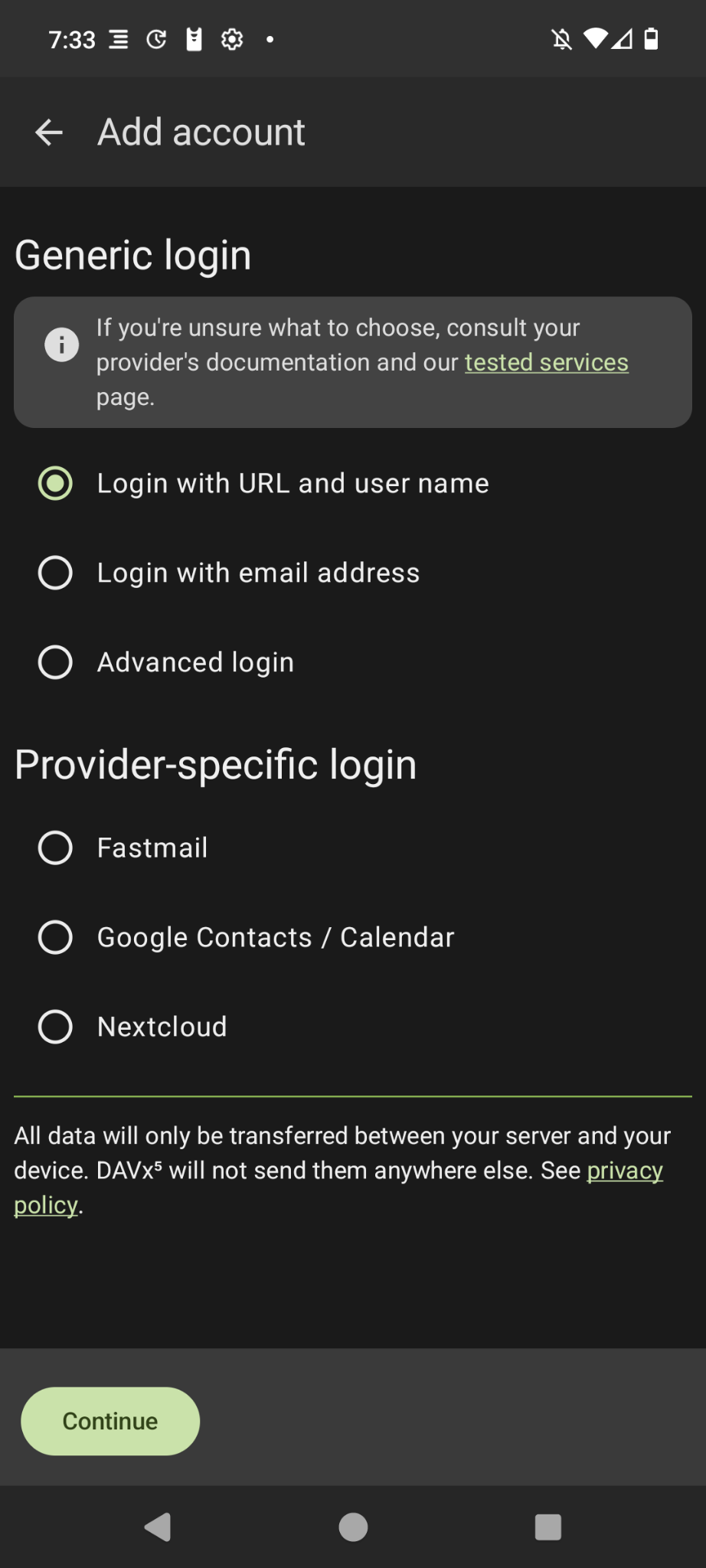

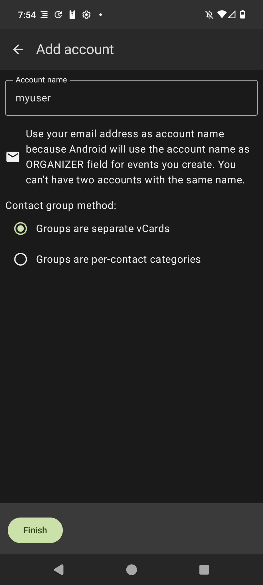

fdroid. Once you install it and open it you’ll click on the plus sign to add
a new account. For our setup with Radicale we need to use the Login with URL and user name.
Here is what you should see. Go ahead click Continue.

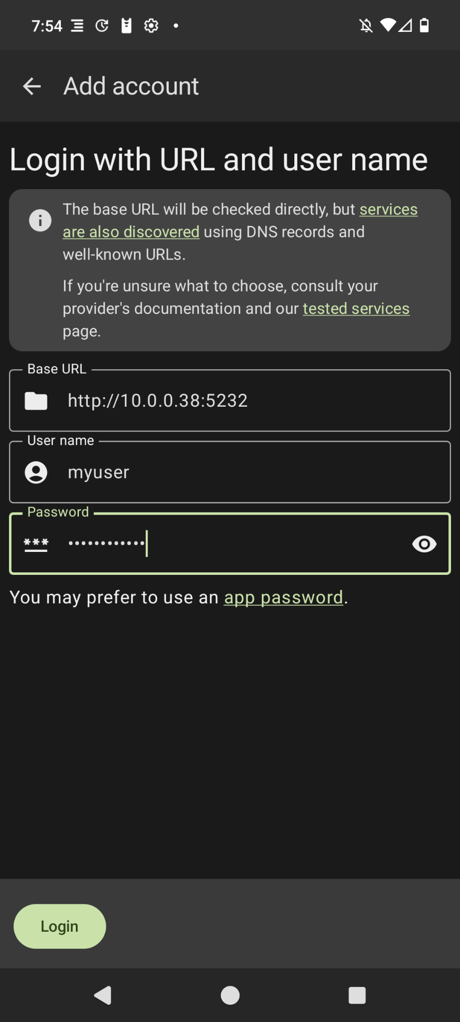

This is the important part. We need to enter in our URL and our login info. You
have to put in the http or it does not work. Enter in http:// then wherever
your container is running. If you followed my steps earlier you just want to
enter myuser and somepassword for the login information.

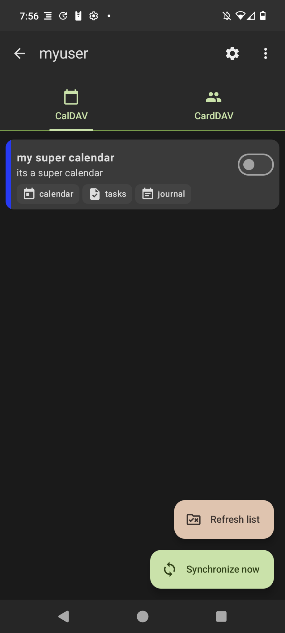

The default here is fine.
Now you should see the calendar we created.
Click on the switch inside the calendar list item. Now your calendar will be
available to apps on your device.

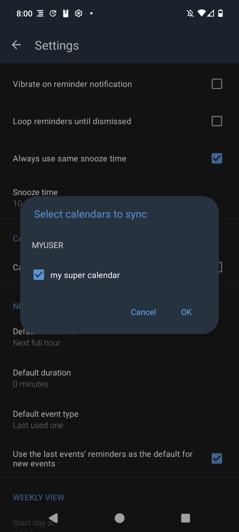

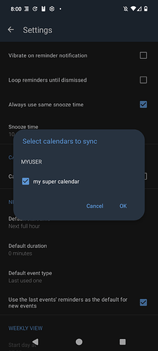

Simple Calendar
When you open simple calendar you will see a gear in the top right. Click on
that and scroll down a little bit. You will see a section labeled CALDAV check
the box for CalDAV sync. When you click that you should see the calendars that
DAVx5 pulled in.
Check the calendar you want hit ok then back out to the main screen.

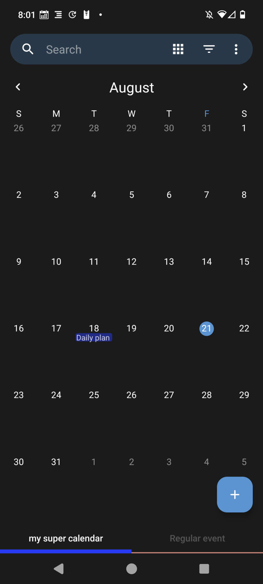

You should see the calendar name at the bottom. Now you can add events and
things and it’ll automatically sync back to your Radicale server.
