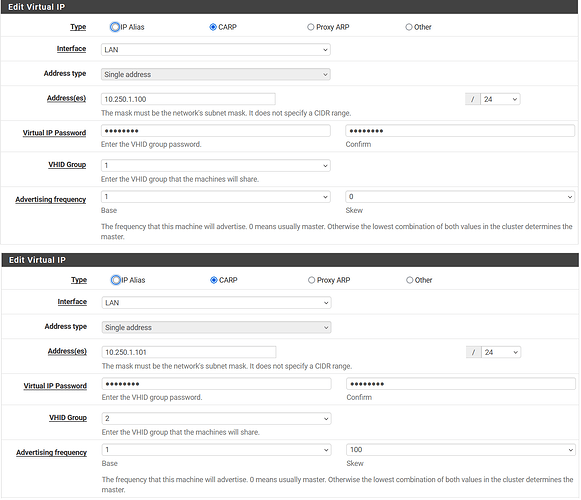

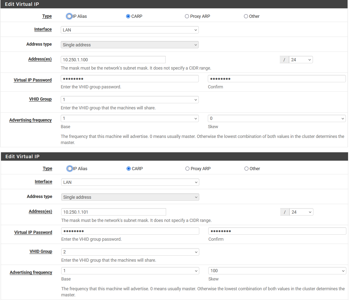

The CARP addresses have been created identically on both appliances with the exception of the Skew (screenshots from Appliance-1, but the config is the same on appliance 2, except the reverse Skew on each VIP):
Appliance-1 VIPs:
So far so good - Both VIPs are created and respond correctly. Appliance-1 is Master for .100 and Appliance-2 is Master for .101
