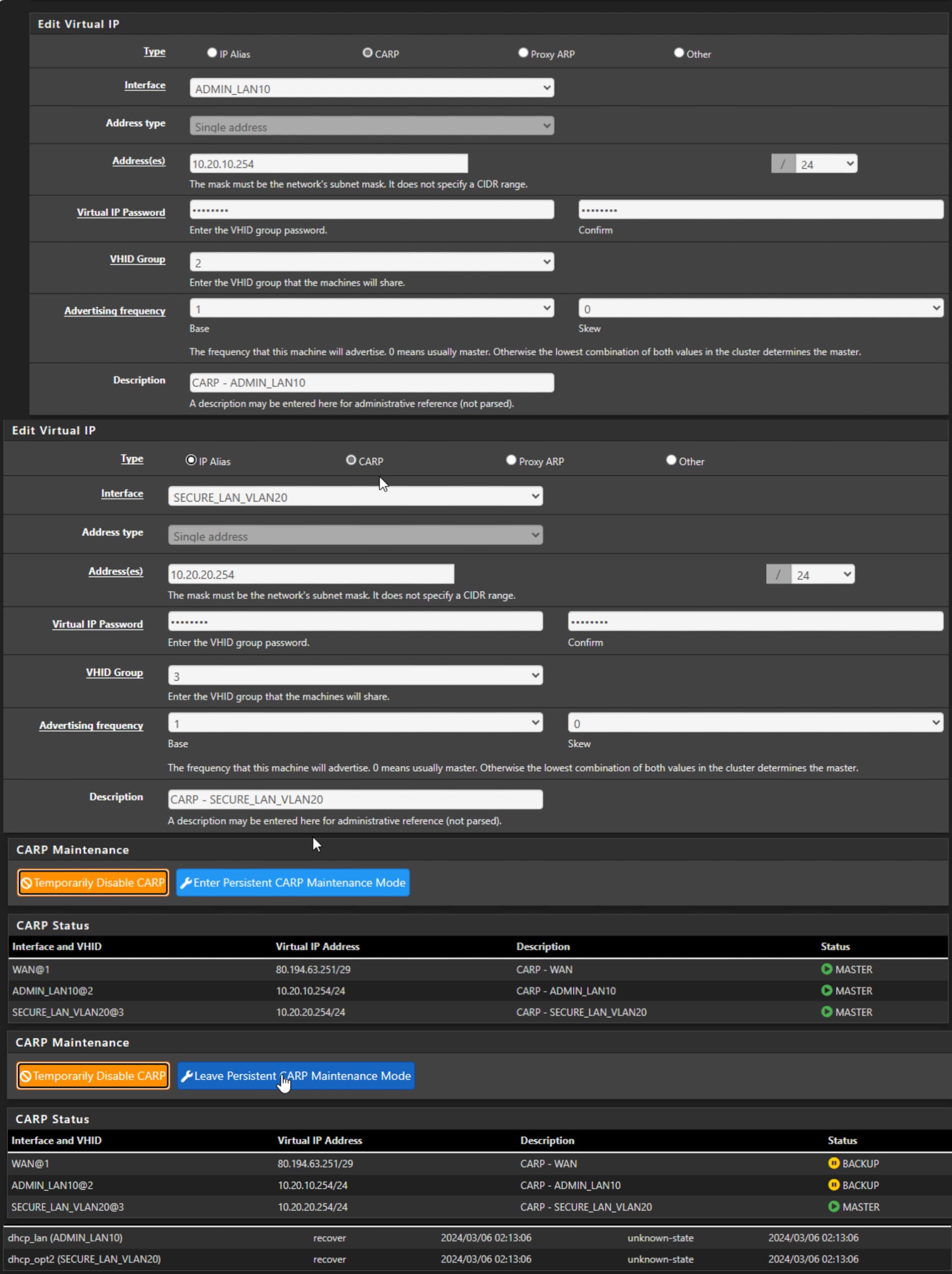

We currently have have a single Virtual PFSense running on a proxmox system with all our VLANS & DHCP working fine. The issue im having is the CARP failover with VLANS on the test server ive setup.
The CARP seems to fail when a vlan is added in the same way you add a lan… both PFSense boxes switch to master & apear to to take DHCP offline for both lan & Vlan. going peer-state unknown.

Ok, so it would apear Proxmox handles this rather poorly. After scrambling round for an unused switch, i have discovered the Proxmox on its own wont do layer 2 switching… once i plugged the 2 vPFsense into the switch they started behaving as expexted…
All the CARP HA responded as primary & backup acordingly and failover works like a charm.

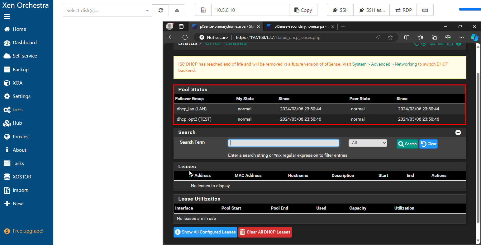

I tested this on xcp-ng and it looks like the internal interface properly handles trunk. I had a lab to test this on here.
