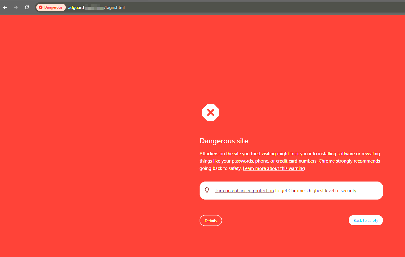

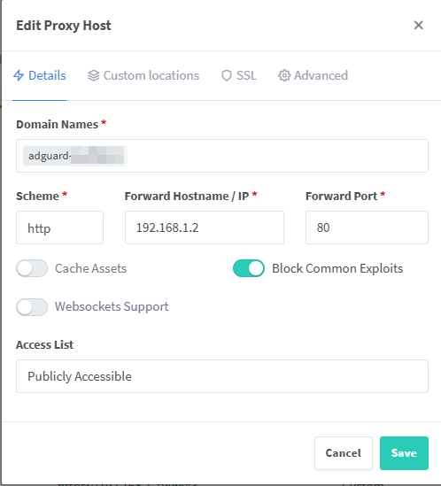

I have npm working fine for most sites I have, but for whatever reason I can’t make it work properly with my self-hosted AdGuard Home.
The host in npm is configured properly (I have a wildcard SSL cert for my domain on the SSL tab), and if I choose to continue on the “Dangerous Site” message, everything works, but the whole point of having npm is to never get any kinds of alerts on the browser, especially not a red page like that…
Am I misconfiguring something either on npm or adguard home?
My adguard home runs just via http (no https) and there’s nothing special about it…
Thanks!
Is this site publicly accessible? If so, what is the exact URL structure? The part after ‘adguard-’ seems rather short for ‘adguard-something’ to be just a subdomain, or if it is a subdomain, then the domain name must be rather short. Therefore, the URL is probably something like ‘adguard-something.xyz.com’ or ‘adguard-home.xyz.com’. Especially the last one, would be exactly what scammers would use for a phishing site.
Also, what top-level domain are you using? Is it a free one, or one such as .xyz, which are often used by malicious actors?
Any of these factors, or of course if your site has actually been hacked and/or is distributing malware, could cause Google to classify your site as unsafe or malicious. This can happen through user reports or, more likely, through an automated process at Google.
In your case, I would guess that it is most likely a false positive, i.e. some AI bot at Google has incorrectly identified your site as malicious due to the URL you are using.
thanks! This is an internal reverse proxy and nothing is exposed to the internet in any way.
the FQDN for my adguard server is adguard-01.my-last-name.net where I own and control “my-last-name.net

I was able to solve the issue by turning off the “Block Common Exploits” option in the hosts configuration.
