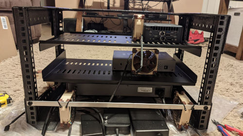

Although you might think about just using a small fan to blow some air across it. It will likely cool it down quite a bit. I’m using regular case fans in various spots with low noise adapters on my rack to keep things cool, this picture was during mock up:

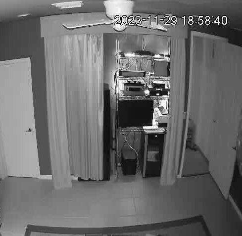

I fortunately have a recessed area under the stairs for a wire rack for all my AV and IT gear, behind motorized curtains and projection screen. Keeps everything out of enclosed cabinets, well ventilated, and out of sight.
