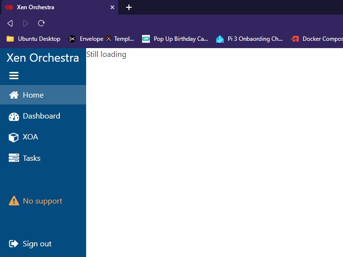

When I access XenOrchestra via its local IP, it loads just fine. However when I try via the URL (as set up in HAPorxy) I can log onto the portal but only the menus load.
Is there possibly something I need to do differently for XenOrchestra when trying to set up access using HAProxy?
