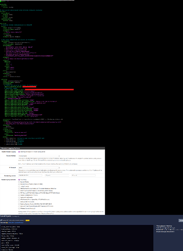

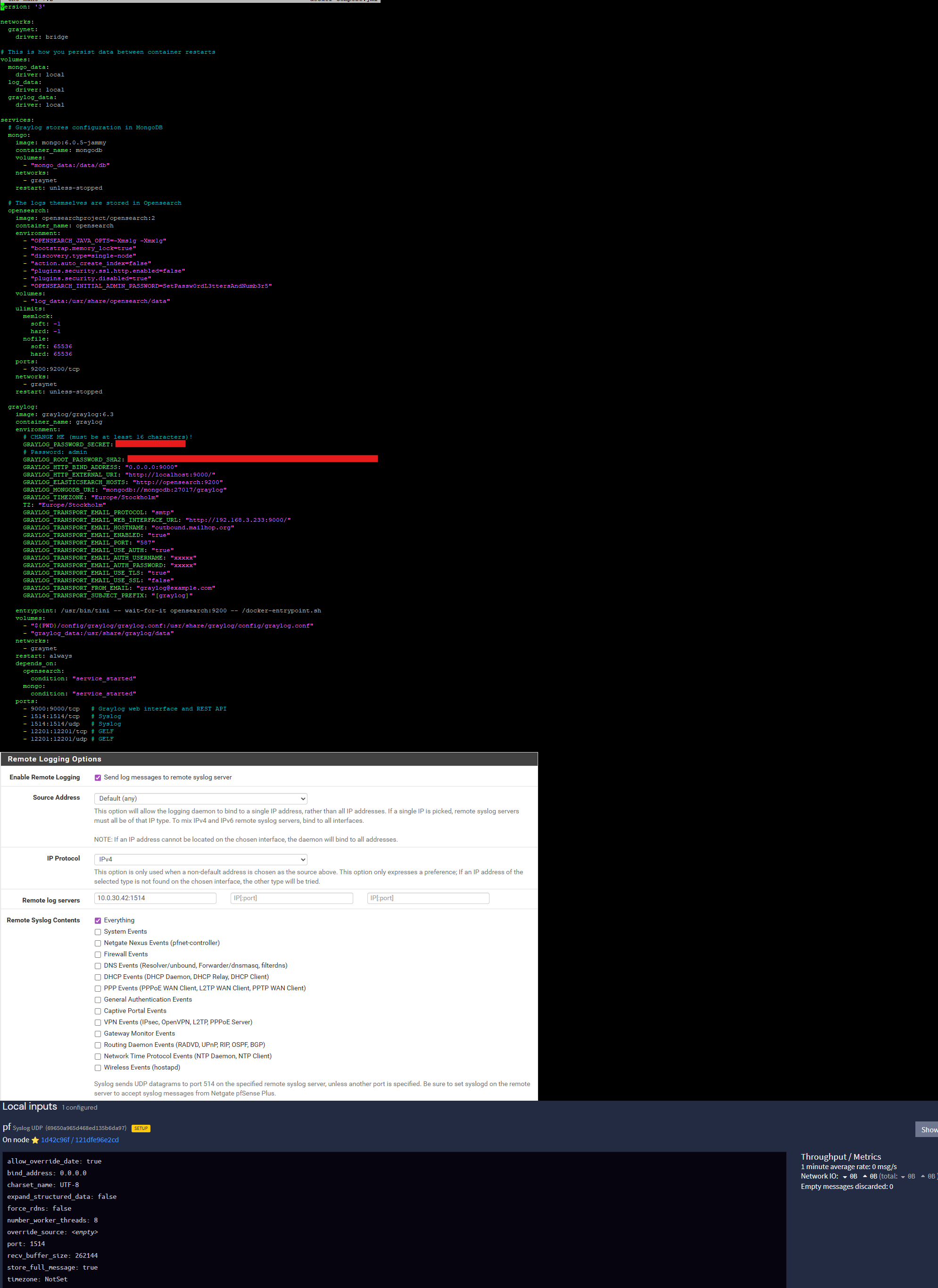

But Im having some issues to get the logs over to graylog. Im successfully sending log traffic from pfSense to my Graylog server, but Graylog does not show the logs in the UI
Traffic reaches the Graylog host and this is confirmed with tcpdump. Traffic is forwarded into the docker container correctly. Graylog is listening on the configured UDP port.
At this point pfsense is sending logs, Graylog is receiving packets but it does not show up in the GUI.
Do you got any ideas where I can troubleshoot to find the issue?
batman@batlab:~/graylog$ sudo tcpdump -ni any port 1514
tcpdump: data link type LINUX_SLL2
tcpdump: verbose output suppressed, use -v[v]… for full protocol decode
listening on any, link-type LINUX_SLL2 (Linux cooked v2), snapshot length 262144 bytes
14:56:52.069814 eno1 In IP 10.0.30.1.514 > 10.0.30.42.1514: SYSLOG syslog.error, length: 55
14:56:52.069851 br-f15df578e99f Out IP 10.0.30.1.514 > 172.18.0.4.1514: SYSLOG syslog.error, length: 55
14:56:52.069857 veth23f4fc7 Out IP 10.0.30.1.514 > 172.18.0.4.1514: SYSLOG syslog.error, length: 55
14:56:52.069923 eno1 In IP 10.0.30.1.514 > 10.0.30.42.1514: SYSLOG local0.info, length: 152
14:56:52.069923 eno1 In IP 10.0.30.1.514 > 10.0.30.42.1514: SYSLOG local0.info, length: 154
Thanks!
Are the metrics on that bottom screenshot showing any data?
I had the same problem. Created the input, checked incoming trafic, all ok. Metrics stay on 0.
Forgot to press the “Setup Input” button.
