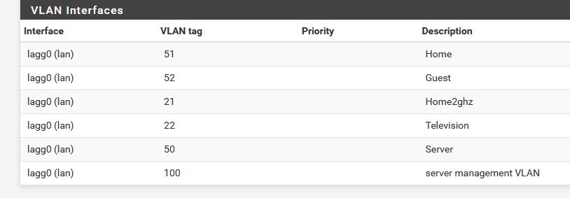

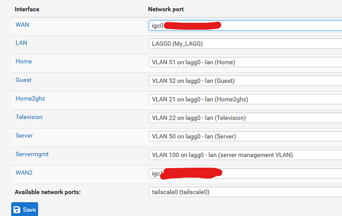

I am not sure if my approach is the best or even proper, but I do not put any VLAN on the LAN interface.I do create a LAGG first on the LAN interface but then I create new interfaces for each VLAN. Then I create firewall rules for each interface to segregate them as I wish, I leave LAN as the default VLAN of 1
