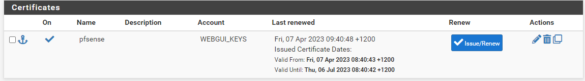

I have created the Account Key, and certificate which issued successfully. It was setup using DNS-Cloudflare.
However when I browse to pfsense.mydomain.com:10443 I still get a “Not secure” warning
